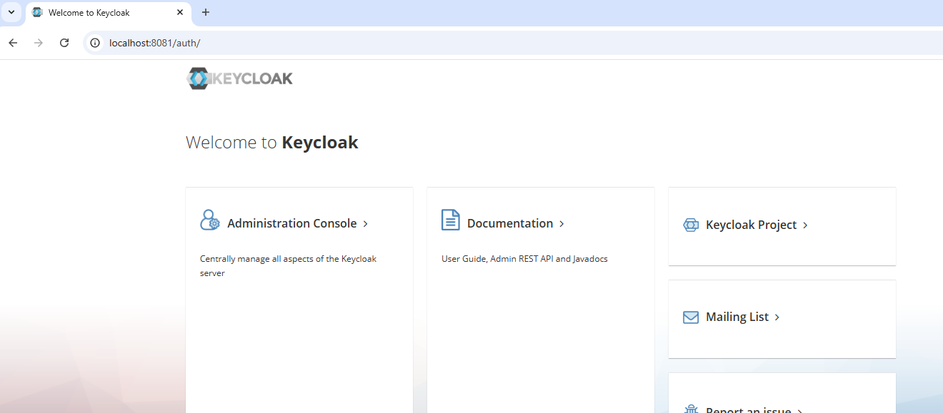

You can also use the Keycloak UI to make custom configurations.
It is accessible through https://<proxy address>/auth/ or
via http://<keycloak address>:<keycloak port>/auth/:
We’re using the standard version of Keycloak, with no major modifications.
