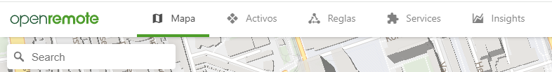

I have been trying the default functionalities, but now I want to add a new option for the following menu, that will be “Forecasting”.

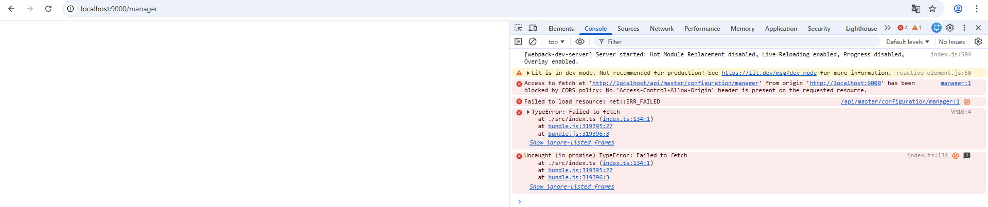

Can anyone tell me how is it that when using the port https://localhost/manager/ it always works, but when I try to use http://localhost:9000/manager I see a blank page with this problem?
I believe its only a port problem, and I have to configure that to actually use the version with my changes. What I always do is (on my project):
docker compose up -d
and then once I see its running I go to the …/manager folder and use:
yarn serve --env managerUrl=https://localhost --env keycloakUrl=https://localhost
I’ve also run into this before.
What helps for me is adding adding a / at the end of the URL in your browser: http://localhost:9000/manager/
Hi, I have tried and now it says “Not found”.
For some reason the localhost still works, but the port 9000 does not. I tried putting “DEV_MODE” from the Dockerfile = True. Still nothing, but now the link it appears is:
https://localhost/realms/master/protocol/openid-connect/auth?client_id=openremote&redirect_uri=http%3A%2F%2Flocalhost%3A9000%2F&state=c192040b-190e-4e66-9757-cf9039c2f76b&response_mode=fragment&response_type=code&scope=openid&nonce=437bd258-8906-4727-aff8-91a20702f381&prompt=none&code_challenge=B2ClsbUFODm_lURrygAVDnimsLIzqTbXLm-FWqPs1_U&code_challenge_method=S256
Hey everyone, I already found the solution. Modify the DockerFile and change this variable to true:
OR_DEV_MODE: ${OR_DEV_MODE:-true}
This would restart the Open Remote project and with localhost:9000 you should be able to now see the normal screen
