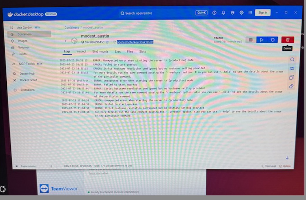

Made photo’s with iphone, then printscreens:
i just saw for a moment i need to setup a server adres? how, (i saw there is also a terminal insite of this docker).
