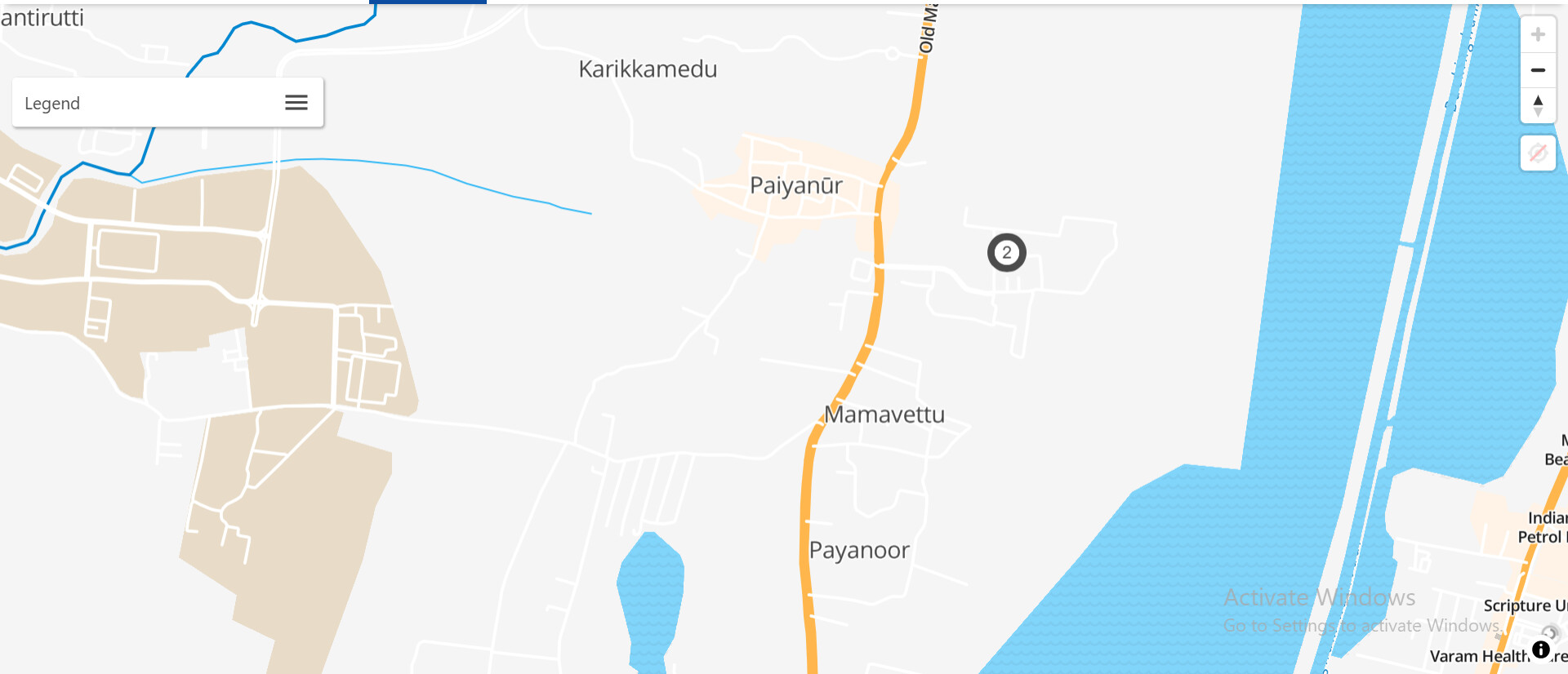

I have added 2 assets for a company on the map, now both the assets are located at almost the same location on the map.
I can see this number on the map instead of 2 individual assets, is there any way to work around this problem?
This is on the max zoom level of 14. Is there a higher zoom level possible? I have downloaded the map using OpenStreetMaps.

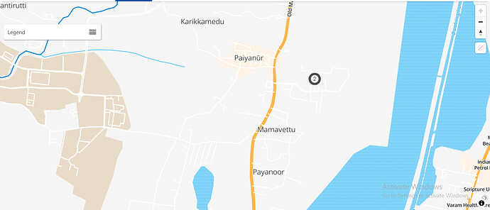

I have tried it with true as well but I can see no effect in the clustering.
Here is the map after keeping clustering as false :
Even at clustering as true and clusterMaxZoom as 12, I was still seeing this cluster.

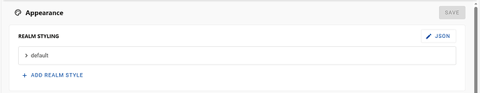

Hello, I have figured it out.
Updated the map_config from the appearance UI
Now it is working.
Great!
Yes, I would recommend doing this through the appearance page, as that should point to the correct manager_config.json file.
