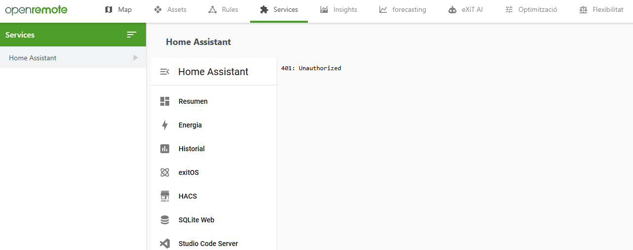

Greetings,
I have been trying to add Home Assistant as an external service to Open Remote, which by the looks of it, it worked. However, most of the actions rises a problem with not being authorized to do them, even if every time I access it I use my login credentials from Open Remote. Does anyone know if its a thing from the browser, or my code?
I have prepared a file to prepare the connection, which is:

Hi!
This sounds like a problem specific to Home Assistant with the URL you are using.
You can check your browser logs to see what is actually happening in the background.
It might be that Home Assistant requires a “redirect to the login page”,
but might not redirect within this window.
What actually makes me wonder is how is it possible that I can access any functionality from “base” Home Assistant, but the moment I try to use any kind of extension / addon this problem occurs.
I will be looking at your advice, thanks!
