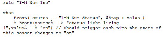

Just to be sure whether it is important or not. In your rule “I-M_Num_Inc” there are two events in the LHS. There seems to be no separator beteen those. But is there really not? In notepad it shows as spaces. But when I open the same file in wordpad in between the spaces there is a character which wordpad displays as
Â
print screen;
Do I need to bother about that Ã? if not, should there be no “or” or “and” kind of thing?
Pobably basic syntax, but I’m really not familiar with this kind of code.
And just for my understanding. The first event in the rule is actually not a condition, but we just use it to capture the value of I-M_Num_Status, right?
Many thanks!
There is no need for a separator between Event()'s on the LHS. Drools assumes AND there as default. The character displayed by wordpad is bogus. There should be none.
That's interesting.
I've never seen that happen before, probably a good idea to get rid of that extra character. (I copied and pasted that bit of text from your post)
As for the lack of "and", as I say, I haven't adventures into dual source rules on my own rules yet.
I believe it is correct, having looked at other posts and seen advice from people like Michal and Richard.

execute.command(“sts_Bram_Hue_counter”,1) ;
end
Probably another solution would be to set the sensor as range instead of custom (as stated above, I know. My mistake. But I read in another topic that it was better to use custom sensor at all times). Will try that later.
But now, I can see in my UI, as soon as I push the wall sensor, so KNX gives it state “on”, it keeps adding. After one second or so, the sensor had value 15.
And if u think about it, it is logical. In the RHS, it changes a value which is used in the LHS. So it fires again. See drools log below.
Any suggestions, so I can add only once per push?
DEBUG 2017-11-25 16:13:35,346 (Drools): rule “Hue Bram via schakelaar” // (package org.openremote.controller.protocol)

I solved the fact that it kept counting. KNX keeps the state of a group address, that is standard. Some wall switches can send integer values instead of on or off, but not all.
Below is the set of rules to obtain. However two concerns still:
  • it always adds twice. the rule gets fired a second time before the variable sts_schakelaar_Bram_counter is being reset (rule log at the bottom). I might add a delay in the rule, but I was hopeing for something more solid. Also can I add ms instead of seconds? One second would be too much. Or altnernatively, I would program my follow-on steps depending a value of + 2. But I doubt whether that would be reliable enough. Or maybe it can be done with some additional Java code?
  • More general. For this counter alone I have now at least 4 rules and 2 in memory commands. The amount of rules I have is getting quit large and I still have some ideas for future stuff. I have already about 40 rules and 20 in memory commands in total. What about performance? All these rules need constant polling, no? I have OR running on a pi 3B.
Many thanks for any suggestions!!
rule “run at init”
then
execute.command(“sts_Bram_Hue_counter”,0) ;
execute.command(“snsr_schakelaar_Bram_counter”,0) ;
end
rule “Hue Bram via schakelaar on”
when
Event(source == “status licht living 1”, value == “on”)
then
execute.command(“sts_schakelaar_Bram_counter”, 1 ) ;
end
rule “Hue Bram via schakelaar off”
when
Event(source == “status licht living 1”, value == “off”)
then
end
rule “Hue Bram via schakelaar counter”
when
Event(source == “snsr_schakelaar_Bram_counter”, value == 1)
Event( source == “snsr_Bram_Hue_counter”, $Step : value )
then
execute.command(“sts_schakelaar_Bram_counter”, 0 ) ;
Integer iStep = Integer.parseInt($Step.toString()) ;
iStep = iStep + 1 ;
execute.command(“sts_Bram_Hue_counter”, iStep ) ;
end

In the default CLOUD rules engine mode adding delay is the only option. You can do this delay in milliseconds, which is in fact default. Typical 300 ms is a good value for debouncing.
However, if you have the rule ending in the STRAM mode (it was a discussion here how to do it a while ago, search for fusion), then you can use a better construction like:
iStep = iStep + 1 ;
end
when
$e: Event(source == “snsr_schakelaar_Bram_counter”, value == 1)
Event( source == “snsr_Bram_Hue_counter”, $Step : value, this before $e )
then
The rule will fire only if the flag was set to 1 after the counter was stable. After increasing it it wouldn’t be increase anymore without resetting and setting again the “snsr_schakelaar_Bram_counter” flag.
