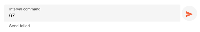

I try now when clicking the send button on the UI like below to send the data to the command topic of Chirpstack:
Unfortunately without success. On the manager logs i see no logs only an inline send error as above in the picutre.

This is what we use and it has worked flawlessly. We still get the ‘send failed’ message but the command downlinks successfully. Data is base64.
