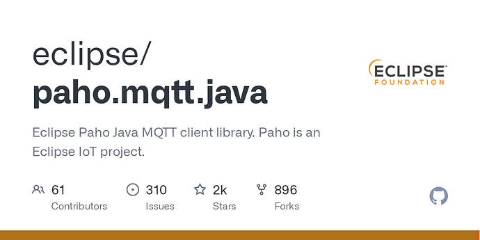

The following libraries are suitable for communicating with a via MQTT.
