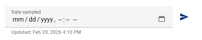

in the UI a date is not rendered:
once i click arrow, it shows date, which again disappears after reload the page
I don’t understand the full context behind this.
Does the attribute have a value in the screenshot?
