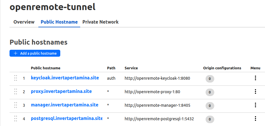

Hello @michal , I have tried to make my cloudflare tunnel container into one network with the openremote container
Then I have also added the public hostname and service on cloudflare according to the openremote container address on docker.
The keycloak address is successfully tunneled and can be opened in the browser.
Likewise, the manager address was also successfully tunneled
But why for the proxy address cannot display the openremote login page when tunneled using cloudflare? is there a step that I forgot?
