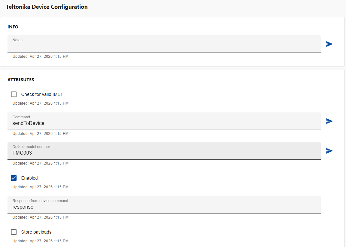

3. Using a different device (FMC920)
What is the correct approach when using a device other than FMC003?
  • Should I create a new Teltonika Model Configuration Asset for FMC920?
  • What should I do if my FMC920 appears in the system as an FMC003 device (the Model Number field in the Car Asset shows FMC003 for IMEI xxxxxxxxxxxxxx)?
What with Deafult model number here?

  2. The default configuration for the FMC003 is there so that there is a starting point for users to add their own devices. Currently, if there is no configuration available, the Teltonika integration cannot retrieve critical information about itself, so it starts misbehaving. I recommend creating a new Teltonika Model Configuration asset first, configuring it, and then deleting the default one.
  3. The idea is that you create a different model configuration asset as described above, and then set the default model number to “FMC920”, so that OpenRemote knows that when devices connect, it should use the FMC920 asset to decode the incoming values.

I have a few questions regarding this approach.
Does setting the default model number to “FMC920” mean that every device connecting to the server via MQTT will be treated as an FMC920? What happens if I later want to connect a different model, for example FMC003? Wouldn’t this effectively limit the system so that only one device model works correctly?
Also, what exactly happens when I change the Model Number field for a specific asset (e.g., with IMEI xxxxxxx)? Will OpenRemote then use the Teltonika model configuration asset with the matching name and start interpreting incoming data based on its parameters?
Finally, if a device (e.g., FMC920) connects to the server before I create the corresponding Teltonika model configuration asset and define its JSON parameters — will I need to delete and recreate the device asset (IMEI) for the data to start being decoded correctly? Or will it automatically pick up the configuration once it’s added?

For the current version of fleet management, yes, but that is not catastrophic, as a very big percentage of the actual parameters to be parsed are constant across different types of devices.
Yes. The idea is that by default, the asset is assigned that default model number, but once the asset is created, you can manually change it and that will use the correct parser.
