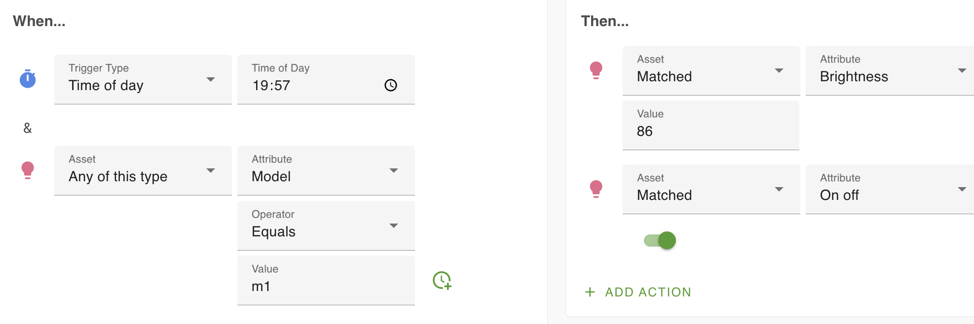

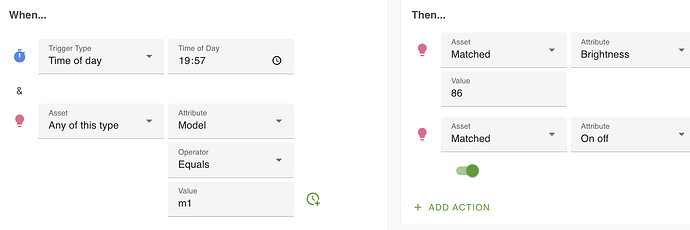

I am trying to make a rule, that allows to update set of assests using some property.
For example where for all the Light Assets where Model==‘m1’
Or for example for all the assests where each of them has tag ‘myTag’
