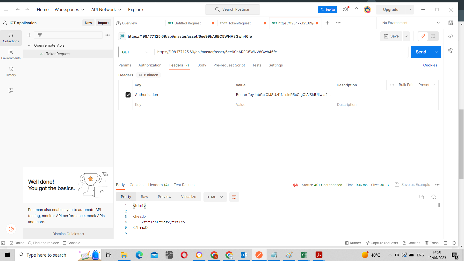

We tried our best to test REST API on postman, but it is showing 401 unauthorized error. Please guide me to resolve this, also guide me the right steps:

For getting information about a specific asset I did the following:
- Create new request in Postman.
- Set the request method to âGETâ.
- Set the request URL to: https://{your-openremote-url}/api/master/asset/{assetID} (see also OpenRemote Manager HTTP API Swagger UI )
- Add an
Authorization
header to the request and set the value toBearer {access_token}
, where{access_token}
is the access token obtained in the previous step. - Click âSendâ button to send the request to OpenRemote.
But here I am getting error as below attached: is the way I wrote âBearerâ and after that access token is right?
