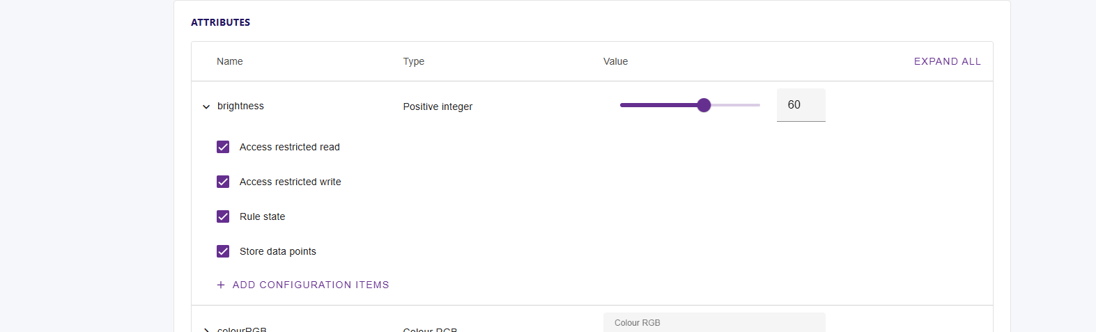

A restricted user cannot read or write any attributes by default.
So, you need to manually enable access for each attribute they’d have access to.

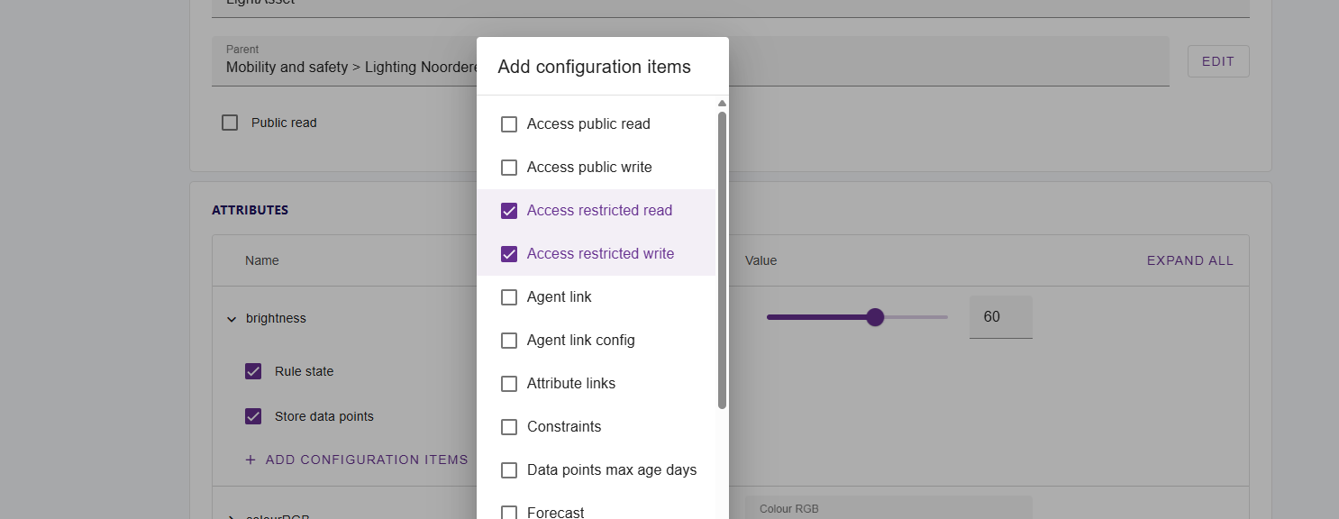

You can add the ACCESS_RESTRICTED_READ and / or ACCESS_RESTRICTED_WRITE
configuration item for this. In case of the map, you also need access to the location attribute.
See here:
