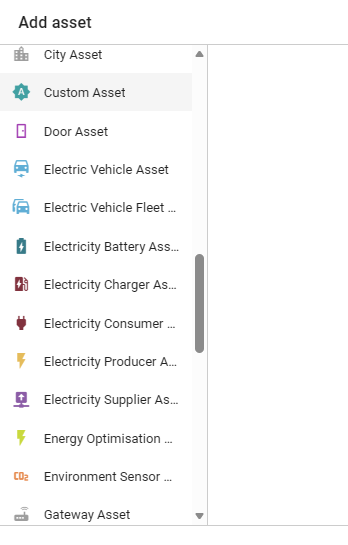

But the new Asset Type is not visible there:
Have I forgotten something, or why isn’t it working? I’m also confused about two things…
The tutorial says: “Inherit the Car Asset Type” (Tutorial: Create your own Fleet Management System · openremote/fleet-management Wiki · GitHub)
But the official documentation says: “Extend VehicleAsset” (Custom Asset Types · openremote/fleet-management Wiki · GitHub)
That’s a contradiction, isn’t it? :thinking:
I will answer myself :wink: i have found the problem. Important was to delete the existing docker volume, not just stop the container.

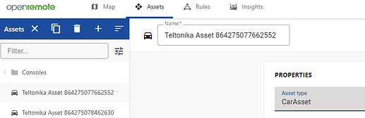

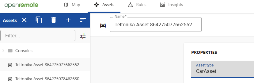

I have a question: When I configure my tracker (FMC003), the device automatically appears in my OpenRemote project. However, it’s recognized there as a CarAsset, and I can’t change the asset type.
If I add a new asset with my own asset type, how do I link it to my tracker?
Did you change the reference here?
No, I haven’t adjusted that. Is that the only place, or are there others? Should I delete the two existing assets and wait until they are recreated?
That’s the only reference you need to change.
To change the asset types, you’ll need to delete them so that they can be recreated.
Best of luck!
Thank you so much, that was the trick and now it’s working!

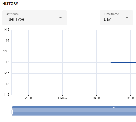

Is there a way to display the fuel type differently?
Right now I only see the numbers and need to know what they are.
Can this be changed somehow?
9 Bifuel running Gasoline
10 Bifuel running Methanol
11 Bifuel running Ethanol
12 Bifuel running LPG
13 Bifuel running CNG
14 Bifuel running Propane
Hey @PeterB ,
This would require custom code to be written on top of the fleet management repository.
Essentially, when processing this Teltonika Parameter, you’d need to let OpenRemote know that this is an enumerable property, namely those above elements you mentioned, and make sure it parses them correctly.
