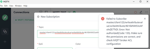

Okay it’s working again, thanks :slight_smile: I guess the problem was that i deleted the default FMC003 Device. Anyway, i followed the Guide how to Connect your MQTT Client. I am able to connect but publish attributes from MQTT Client is not working. I get the following error:
Topic: master/client123/writeattributevalue/writeAttribute/4k1EkNW53oAFolnZE7TtDl
What i am doing wrong?

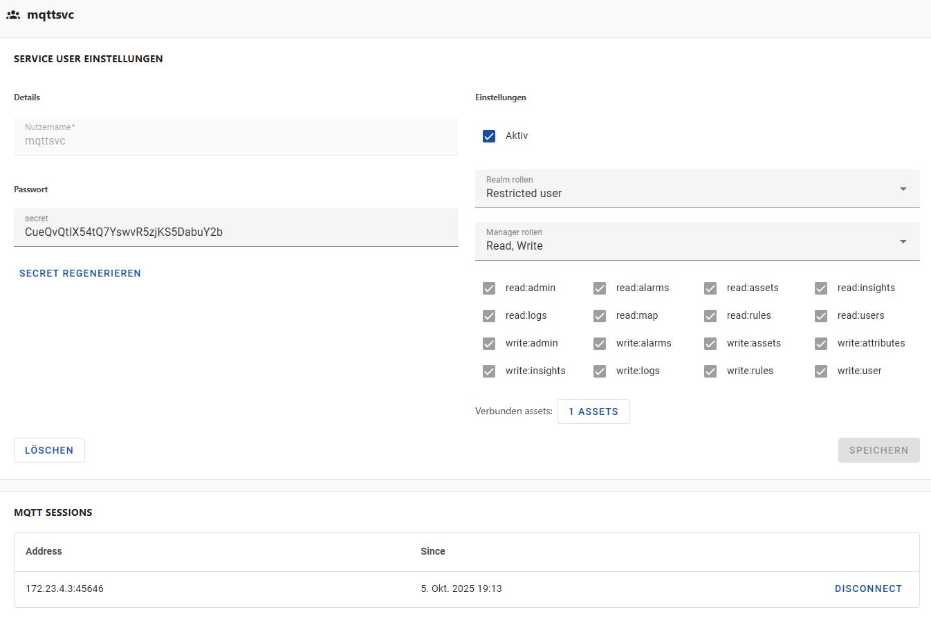

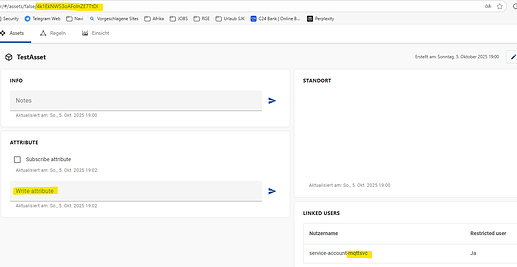

I think i found the problem, i added the topic at the wrong place in the toolbox. Now i can publish but Value does not change at the asset.
The log shows the following: `2025-10-05 19:45:34.962  FINE    [ContainerExecutor-32          ] nremote.manager.event.ClientEventService : Client connection created: /172.23.4.6:35736
2025-10-05 19:45:37.827  FINE    [Thread-1 (ActiveMQ-serve..ost)] nremote.manager.event.ClientEventService : Client not authorised to send event: type=attribute, requestRealm=master, user=service-account-mqttsvc, userRealm=master
2025-10-05 19:45:37.827  FINE    [Thread-1 (ActiveMQ-serve..ost)] mote.manager.mqtt.DefaultMQTTHandler.API : Publish was not authorised for this user and topic: topic=master/client123/writeattributevalue/writeAttribute/4k1EkNW53oAFolnZE7TtDl, subject=org.openremote.container.security.keycloak.AccessTokenAuthContext@29c460a5
2025-10-05 19:45:47.564  FINE    [Thread-1 (ActiveMQ-serve..ost)] nremote.manager.event.ClientEventService : Client not authorised to send event: type=attribute, requestRealm=master, user=service-account-mqttsvc, userRealm=master
2025-10-05 19:45:47.564  FINE    [Thread-1 (ActiveMQ-serve..ost)] mote.manager.mqtt.DefaultMQTTHandler.API : Publish was not authorised for this user and topic: topic=master/client123/writeattributevalue/writeAttribute/4k1EkNW53oAFolnZE7TtDl, subject=org.openremote.container.security.keycloak.AccessTokenAuthContext@19e1c7a4
2025-10-05 19:46:23.791  FINE    [Thread-1 (ActiveMQ-serve..ost)] nremote.manager.event.ClientEventService : Client not authorised to send event: type=attribute, requestRealm=master, user=service-account-mqttsvc, userRealm=master
2025-10-05 19:46:23.791  FINE    [Thread-1 (ActiveMQ-serve..ost)] mote.manager.mqtt.DefaultMQTTHandler.API : Publish was not authorised for this user and topic: topic=master/client123/writeattributevalue/writeAttribute/4k1EkNW53oAFolnZE7TtDl, subject=org.openremote.container.security.keycloak.AccessTokenAuthContext@238b11ab

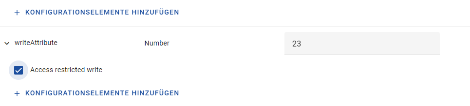

I’m not sure what could be going wrong, but it looks like the restricted service user you made isn’t linked to the asset, or the attributes are not marked with the “Restricted Write” meta item.
Hello @panos , i added “Access restricted write” and now it’s working!
Is it normal that i have to add it there? I think this was not mentioned in the tutorial.

Hey @PeterB ,
The Access Restricted Write meta-item denotes that an attribute can only be accessed by the (service) users that have been linked to that Attribute. Earlier, you linked your service user to that asset, which means that this service user does have the ability to access that attribute. If that service user tries to access another attribute that does have that meta item, and the user hasn’t been linked to that asset, then the write event will fail.
Hope that helps!

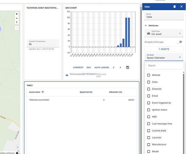

Hello community, I’m currently working on integrating an FMC003 device into the OpenRemote Fleet. Everything has worked fine so far, but I’m running into a problem with the Dashboard (Insights). I added a table, but not all attributes are available within it. For example, I’d like to include the Coolant Temperature value in the table, but it’s not available in the selection. I can pick that value as an individual attribute, gauge, or bar chart, but not within the table. How can this be achieved? Thanks in advance!
Good morning @PeterB ,
This is intended functionality of OpenRemote. What is happening is that the asset type of the Car Asset, that is the asset type of the assets that the fleet integration makes, has very specific and limited predefined attributes in it (which doesn’t, for example, include Coolant Temperature). This means that you cannot use “any of this type” for rules, or insights widgets, on any attributes that are not currently defined by the asset type that is used.
You can find more documentation about this in the wiki. There was a discussion about custom asset types some days ago here.
