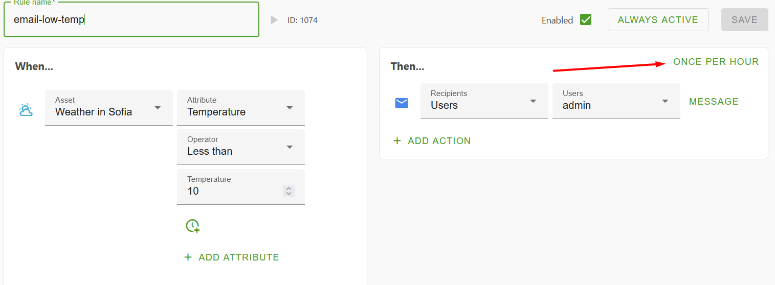

I am trying to email alerts working. Email is maintained in compose-docker.yml, visible if I print env vars. I can get in flow to create web alert(if I setup separate one for test purpose). But I cannot get OR send emails I cannot see it even attempting the logs.
Could you maybe share your docker-compose.yml file? That way we can see the configuration you deployed.
Please make sure to remove any classified information, such as SMTP credentials, secrets, etc.
This is my config. The problem is that I do not see in OR logs(from web interface) that it even attempts to send these.

Thanks for sharing the docker-compose.yml file. I noticed you’re using port 25 for sending emails, which is often blocked by cloud providers. Are you running OpenRemote locally?
Hi, It is run in professional environment - 25 is not blocked. I cannot see logs for attempted sent.
If you can give me some step by step instruction how to send test emails will be appreciated. I have some suspicion that software is not attempting to send the email. I might be doing something wrong with web interface or something…
