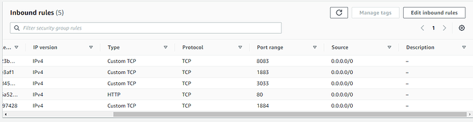

Check if your ingress security group is open on port 8883.
I Think it is open on 8883

I’m not really practical in AWS but you should also check on AWS firewall if 8883 ingress is opened. You can also try with a telnet on port 8883 on your AWS public ip

also try 1883 and see if that is open as well in AWS SG inbound

I have tried that too
Plase note you wrote 8083 instead of 8883
Yeah I added another Custom TCP port 8883 its working now ! Thanks for help
