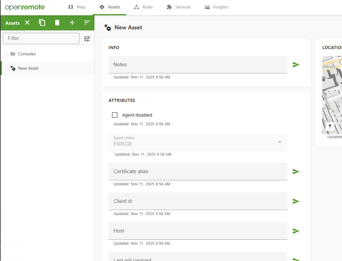

Agents are a common built-in feature that allows linking to external services / devices.
You can use an MQTT Agent to listen for messages on your own broker.
More details here:
As an alternative, you can communicate with our own integrated MQTT broker instead.
You can publish- or subscribe to changes in attribute values that way.
More details on that here:
Many thanks for this.
Time to put pen onto paper. Wish me luck.
