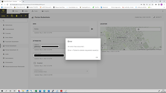

after deleting the interconnection, i’m not be able anymore to delete the gateway?!
Hey @Denis,
I was able to reproduce this quickly; for me if I refreshed after the error message then the gateway asset was indeed deleted. Was this the case for you also?
Obviously the error shouldn’t appear and will put it on the backlog.
