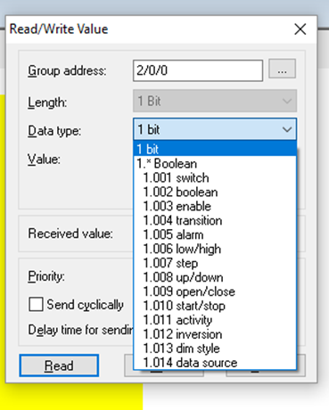

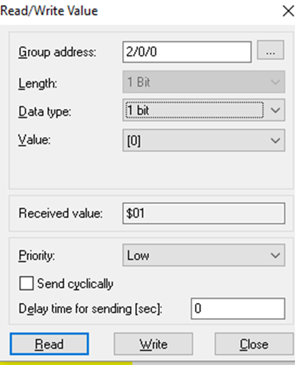

The KNX address is configured as a 1-bit. This i cannot change in the parameters of the suntracer.
See printscreens from my ETS for some more info.
Is there any way I can still read this value so I can use openremote to control my sunscreens? Or is this datatype not supported in at all?
