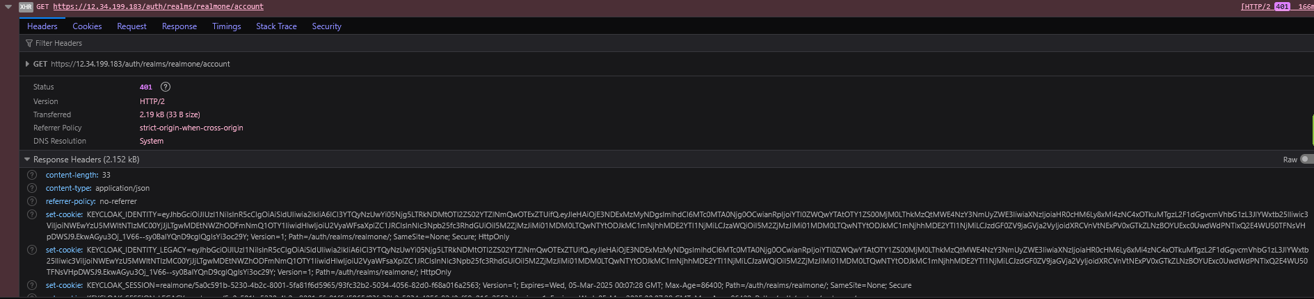

After a clean installation of OpenRemote, from the Super Admin standpoint, everything is working correctly, however, once I create a regular user and try to login, the page remains white. When accessing the browser’s dev tools I received this:
https://IP/auth/realms/realmone/account is displaying a 401 and appears to be something with Keycloak. At one point I thought it said that authorization couldn’t be confirmed, or something along the lines of that in the debug.

Yes, the /auth path is linked to Keycloak, so their endpoint is returning the 401.
Maybe you can share the Keycloak roles / permissions this user has?

After the instance is started I can login as a Super Admin with the provided credentials fine, but when I create a new user in either the default realm or realmone and try to login, the login page appears, and I can successfully login, however the page remains blank; this is where I see the 401 error in the browsers debug. If I navigate through the /auth path I can get to the Keycloak UI and it shows that this new regular user I created is logged in.

I was able to resolve the problem by accessing the Keycloak UI using http://IP/auth/admin . Inside I found that users were not correctly being assigned permissions, after adding these roles the UI for the regular user populated.

It’s indeed an issue: Users: if a user is created with a realm role like 'restricted user' or 'super admin' through the Manager UI, that user can not reach the Manager · Issue #1775 · openremote/openremote · GitHub To be fixed of course in the next release.
Temporary solution is to
  • Go to Keycloak
  • Select the correct Realm
  • Go to ‘Users’ → user → Role Mapping
  • Enable ‘default-roles-…’
