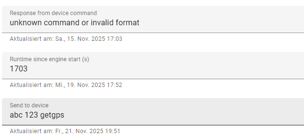

Hey, I need some advice because the “send to device” command isn’t working for me. The following message appears:
INFO    [ContainerExecutor-8208        ] atics.teltonika.TeltonikaMQTTHandler.API : Device 864275077662552 is not subscribed to topic, not posting message
Commands Topic is set correctly in the configuration: master/obdtrac02/teltonika/%imei%/commands
Data Topic is working, i get data from device.
Response from device fields shows errors too
Have I forgotten to set something? What could be the reason?
Good morning @PeterB ,
I can tell from your screenshot that it does work, since the error unknown command or invalid format is an actual message that is sent by the device itself as a response from the command.
Now, I haven’t really decoded the behavior that makes the device disconnect, but sometimes, when an invalid command is sent to the device, the device unsubscribes from the commands topic. There’s not exactly a trove of information for the behavior of MQTT around Teltonika devices, so it takes a bit of a deep dive to decode why the device disconnects from the MQTT topic.
Hope that helps!
Hey @panos, yes sometimes it disconnect but i always get this unknown command response. OR Log shows some errors but i dont know if it is a general problem or if it is related with the mentionend problem.

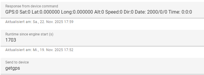

I just tested it out with getgps (note that I am not using any spaces in the command at the start). Does that work?
@panos Yes i tried this command but it’s not working. Response is always the same. I use this structure: smslogin space smspassword space command
For example: usr 1234 getgps

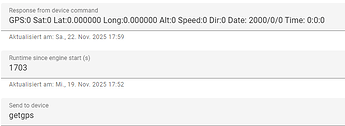

@PeterB what I do during development is remove the battery from the device itself and ensure it’s shut down, then plug it in again. Should make it re-subscribe to the correct topics.
Amazing, now it works! I followed the documentation, which says, “Type the command in the same way you would an SMS command.” That was a little confusing, so I assumed I had to enter my username and password. Even with a username and password set, the command still works!

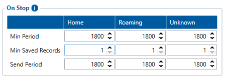

Hello, I have now found the error for the “DISCONNECT: Device disconnected from topic” error and now have a stable connection so that I can send an SMS command to the tracker at any time via Openremote using “Send to Device.” The disconnect from topic occurs when working with the network ping timeout in the Teltonika Tracker. As soon as this ping is sent, the device will be disconnected. I have set the value here to 0.
The Open Link Timeout value is also important here. In my case, I set it to 1 hour (in On-Stop mode, my tracker sends a record every 30 minutes).
The Sleep Settings must also be taken into account. In my tests, the TCP/MQTT connection could only run stably when Sleep Mode was set to GNSS Sleep (or disabled, which consumes more power).
