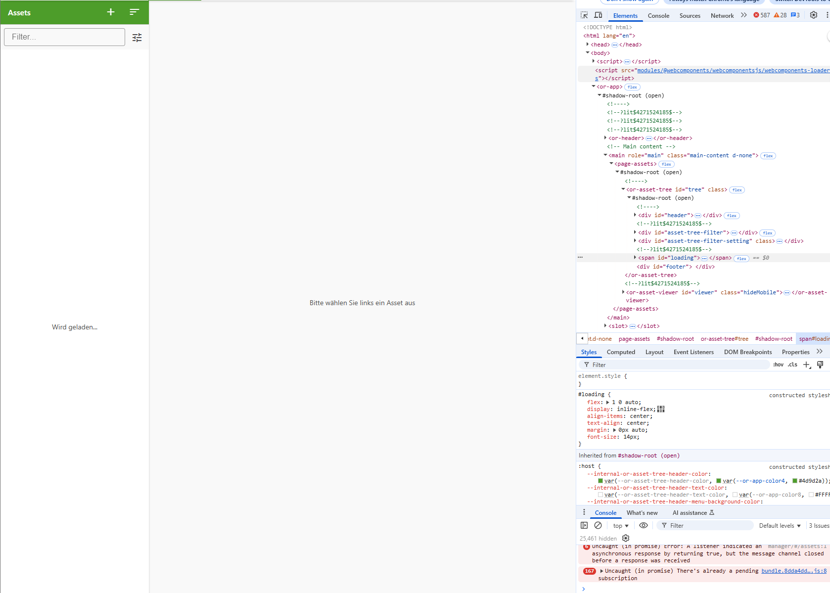

I need some extra hint - now i want to use a fqdn with my existing nginx proxy (reverse proxy).
Note - My virtual machine with openremote works remote on hetzner without any problems. In the same netzwork i can open openremote and modify in 172.18.1.36
I have several virtual machines, and my reverse proxy settings redirects all domain traffic to their machines.
What worked so far:
OR_HOSTNAME=172.18.1.36 docker-compose -p openremote up -d
Normaly all the ssl stuff is done by nginx. And nginx redirects to openremote. Therefore i tried:
OR_HOSTNAME=openremote:fqdn.at docker-compose -p openremote up -d
Now i can browse to openremote:fqdn.at. But with some errors.
Erros:
  • I can login, but on assets tab there are problems in loading content. See attached picture.
This is my proxy settings:

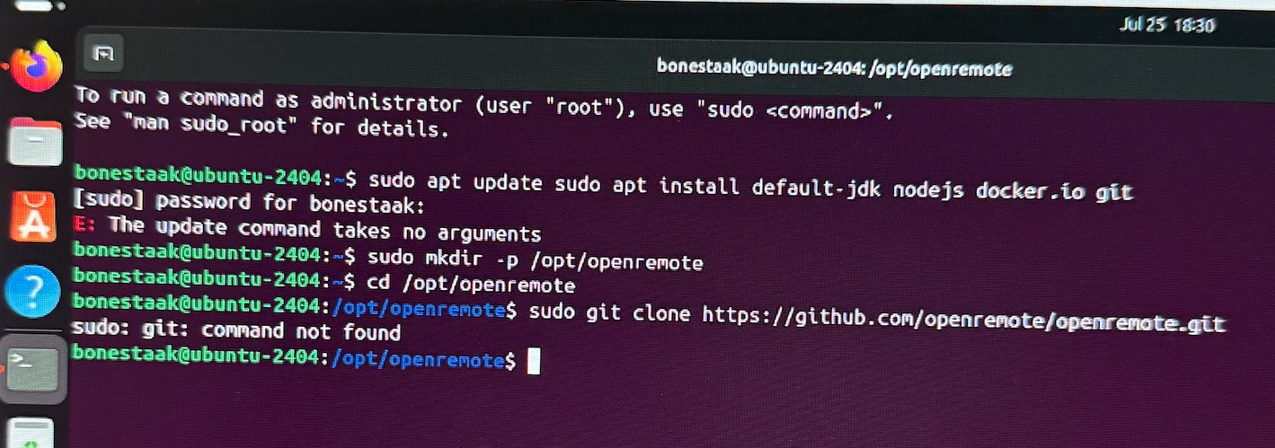

Al these commands ends with error, Git> not found no matter if i do it on a NUC, but also On my Qnap with Ubuntu See here:
I’ve already seen and followed about 30 different links on the forum, but none of them show the complete installation from Linux to Openremote. They always redirect you to a different page where you repeatedly encounter an error or “command not found.” And it has nothing to do with the hardware itself. I initially assumed I was using a NUC, but because everything kept crashing, I switched to my QNAP and installed Ubuntu there, and the same thing happened again. (The QNAP also uses twice the power of the NUC during a Docker installation, a whopping 12 watts more.) The only remaining option is using a Raspberry Pi, but that’s nowhere to be found on the Openremote page.
Is there even a complete installation manual anywhere that doesn’t constantly redirect to other (non-functioning) pages?

Hmm, what do you mean with && are they parameters?
i tried this:
Warning: Failed to open the file /usr/local/bin/docker-compose: Permission
Warning: denied
0 72.0M 0 0 0 0 0 0 --:–:-- --:–:-- --:–:-- 0
curl: (23) Failure writing output to destination
chmod: cannot access ‘/usr/local/bin/docker-compose’: No such file or directory
bonestaak@ubuntu-2404:/opt/openremote$ sudo mkdir -p /opt/openremote
bonestaak@ubuntu-2404:/opt/openremote$ cd /opt/openremote
bonestaak@ubuntu-2404:/opt/openremote$ sudo git clone GitHub - openremote/openremote: 100% open-source IoT Platform - Integrate your devices, create rules, and analyse and visualise your data
Cloning into ‘openremote’…
remote: Enumerating objects: 131367, done.
remote: Counting objects: 100% (1749/1749), done.
remote: Compressing objects: 100% (890/890), done.
remote: Total 131367 (delta 1265), reused 922 (delta 801), pack-reused 129618 (from 3)
Receiving objects: 100% (131367/131367), 283.99 MiB | 29.41 MiB/s, done.
Resolving deltas: 100% (67302/67302), done.
bonestaak@ubuntu-2404:/opt/openremote$ cd /openremote
bash: cd: /openremote: No such file or directory
bonestaak@ubuntu-2404:/opt/openremote$ cd openremote
bonestaak@ubuntu-2404:/opt/openremote/openremote$ sudo docker-compose up
sudo: docker-compose: command not found
bonestaak@ubuntu-2404:/opt/openremote/openremote$ sudo make all
make: *** No rule to make target ‘all’. Stop.
bonestaak@ubuntu-2404:/opt/openremote/openremote$ OR_HOSTNAME=192.168.0.167 OR_SSL_Port=8443 docker-compose -p openremote up -d
bash: docker-compose: command not found
I think directories are different on Qnap docker and there is no path as most of the commands are not found

HI, do you have also information for me running behind proxy with domain?
I already have overviewed your quick start guide. But not sure which information should be useful for my problem.
As I said remote with IP it works. With fqdn docker compose startet it also works but I have errors in Assets. As shown in the picture above.
