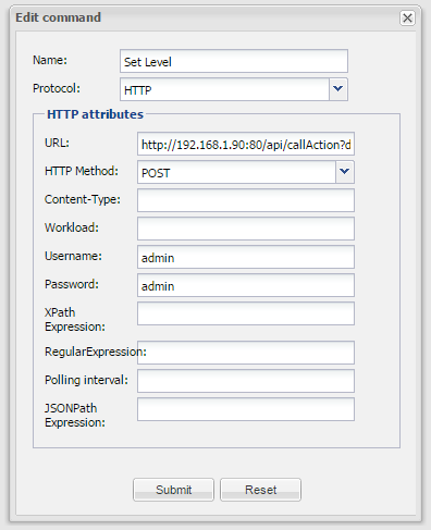

My OR command looks like this .
and the URL I’m using is as follows
http://192.168.1.90:80/api/callAction?deviceID=92&name=setValue&arg1=${param}
…but its not working

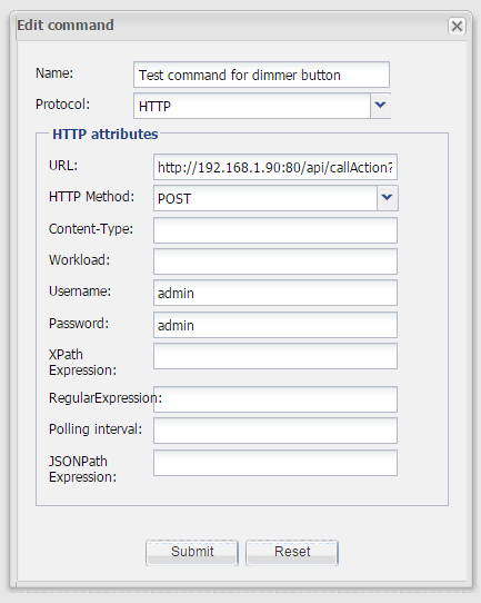

You put a fixed value into the command and link it to a button, does that button work?
If so, I'd assume that it's something to do with the $param?

Can you upload a higher resolution image of how you've setup the slider please?
I tried to zoom in, but got a very fussy image.

I did the button idea and it didnt work and I now think the issue may be with the command firing off the http request
I dropped in a url (that works in a browser) and it doesnt do anything.

images attached (including the one that I used to test with the button)

Hi Frank,
It just comes down to what type of HTTP request your device requires: -
From your first post you said you can call the URL from Chrome (I’m guessing by typing into the address bar) then that is a HTTP GET (not POST), so change your command to GET remove the Workload (that is only for PUT and POST requests) and then set the URL as follows: -
http://[192.168.1.90:80/api/callAction?deviceID=92&name=setValue&arg1=](http://192.168.1.90/api/callAction?deviceID=92&name=setValue&arg1=39)${param}
Should be good.

Hi Richard,
That worked !! - thanks a lot…
I thought I had tried that combination … but evidently not
all sorted now - I can now go and build my panels.
