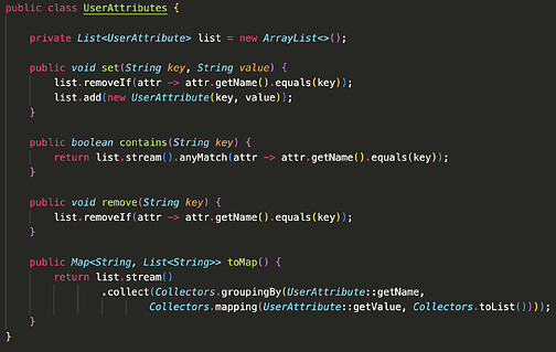

An alternative approach could be to encapsulate the list of UserAttribute objects inside a dedicated class called UserAttributes. By doing this, you keep all the attribute related logic in one place. It makes validation easier, keeps the code more organized, and gives you a simple, consistent way to work with attributes.
These screenshots give an idea of the refactor.
Refactored User class:
New UserAttributes class:
This refactor has several benefits. First, it encapsulates the internal structure of the attributes, so the aggregate interacts with them through a clear and well-defined interface. It also allows attribute related rules to be enforced consistently in one place, such as preventing duplicates, disallowing null keys, or validating formats. Additionally, the UserAttributes class becomes reusable across other entities if needed. Finally, it makes the code easier to maintain, test, and reason about, while also following DDD principles.
