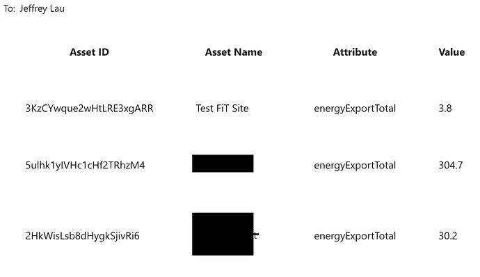

Here is a screenshot of the email I received, it is exactly what I need
What I want is one email summarising all producers’ wattage
