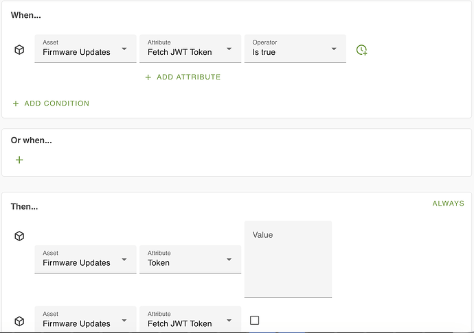

Hello there. I have created a JSON attribute containing an http agent link which returns a token from my Flask server, only when the parameter pollingMillis is used. However, I don’t want to continuously poll for a token. I have removed the pollingMillis and tried to use a When Then Rule to trigger instead, but I can’t get it to work. Is this even possible? Here is a screenshot of my rule:

Thanks for the suggestion about disabling and enabling the agent. Would be nicer if there was a better way to do this - like adding a new parameter to the agent link that would support a boolean trigger. Or if someone knows how the agent link executes from pollingMillis, then could use groovy rules to make it work.
