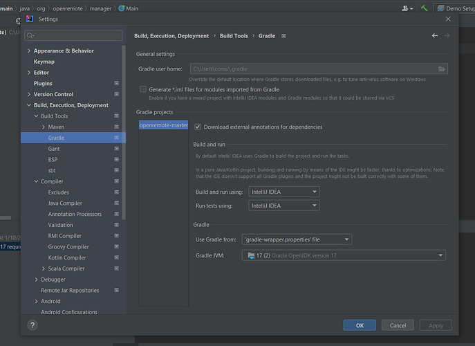

Setting the option “Build and run using” to IntelliJ IDEA in Build, Execution, Deployment -> Build Tools -> Gradle should make the configurations appear like “Demo Setup” and “Empty”:
(screenshot of my IntelliJ IDEA Ultimate instance)
The ‘Running and debugging the Manager’ section also describes a custom configuration in case of using custom projects, since classpath and main class specifications differ there.
