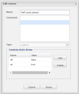

sample command http request - http://192.168.1.90:80/api/devices/6/action/turnOff
This is what I use to control one lamp (screenshots attached)
3 x Commands
Lamp On
Lamp Off
Lamp Status
1 x Sensor
1 x switch
Hope this helps
