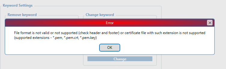

I receive the following error message when I try to upload the certificate.
If I only use the root certificate (ISRG Root X1), the upload works. I can also connect to the MQTTX tool via MQTTS, but I get an SSL handshake error when establishing a connection with the Teltonika devices. The device is connected, but the SSL error message puzzles me. So my question is: is it enough to have the root certificate in the device, or does it have to be as described in the instructions?
Hello, does anyone have any ideas? The tracker connects and delivers data, but the error messages are puzzling me. As mentioned before, I only imported the root CA into the FMC003, but not the reverse chain. It couldn’t be imported.

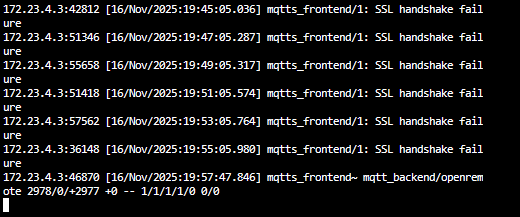

Nov 18 13:55:19 srv.example.com haproxy[2166674]: 212.65.103.86:59237 [18/Nov/2025:13:55:17.367] mqtts_frontend~ mqtt_backend/openremote 2480/1/+2480 +0 -- 1/1/1/1/0 0/0 [SSL: Ver=TLSv1.2 | Cipher=ECDHE-RSA-AES256-GCM-SHA384]
Nov 18 14:00:04 srv.example.com haproxy[2166674]: 212.65.103.86:51492 [18/Nov/2025:13:59:54.259] mqtts_frontend/1: SSL handshake failure
Nov 18 14:05:05 srv.example.com haproxy[2166674]: 212.65.103.86:51493 [18/Nov/2025:14:04:54.795] mqtts_frontend/1: SSL handshake failure
Nov 18 14:07:27 srv.example.com haproxy[2166674]: 212.65.103.86:59238 [18/Nov/2025:14:07:23.927] mqtts_frontend~ mqtt_backend/openremote 3502/0/+3501 +0 -- 1/1/1/1/0 0/0 [SSL: Ver=TLSv1.2 | Cipher=ECDHE-RSA-AES256-GCM-SHA384]
Nov 18 14:10:06 srv.example.com haproxy[2166674]: 212.65.103.86:51494 [18/Nov/2025:14:09:55.660] mqtts_frontend/1: SSL handshake failure
Nov 18 14:14:50 srv.example.com haproxy[2166674]: 212.65.103.86:59239 [18/Nov/2025:14:14:35.743] mqtts_frontend/1: SSL handshake failure (error:0A00010B:SSL routines::wrong version number)
Nov 18 14:15:06 srv.example.com haproxy[2166674]: 212.65.103.86:51495 [18/Nov/2025:14:14:55.849] mqtts_frontend/1: SSL handshake failure
Nov 18 14:53:53 srv.example.com haproxy[2166674]: 212.65.103.86:59260 [18/Nov/2025:14:53:28.705] mqtts_frontend/1: SSL handshake failure
Nov 18 14:54:56 srv.example.com haproxy[2166674]: 212.65.103.86:59261 [18/Nov/2025:14:54:45.947] mqtts_frontend/1: SSL handshake failure
Nov 18 14:55:10 srv.example.com haproxy[2166674]: 212.65.103.86:51503 [18/Nov/2025:14:55:00.006] mqtts_frontend/1: SSL handshake failure
Nov 18 14:55:38 srv.example.com haproxy[2166674]: 212.65.103.86:59262 [18/Nov/2025:14:55:27.800] mqtts_frontend/1: SSL handshake failure
Nov 18 14:57:38 srv.example.com haproxy[2166674]: 212.65.103.86:59263 [18/Nov/2025:14:57:27.570] mqtts_frontend/1: SSL handshake failure
Nov 18 14:59:39 srv.example.com haproxy[2166674]: 212.65.103.86:59264 [18/Nov/2025:15:25:30.650] mqtts_frontend/1: SSL handshake failure
Nov 18 15:27:41 srv.example.com haproxy[2166674]: 212.65.103.86:59278 [18/Nov/2025:15:27:30.814] mqtts_frontend/1: SSL handshake failure
Nov 18 15:29:44 srv.example.com haproxy[2166674]: 212.65.103.86:15128 [18/Nov/2025:15:29:30.993] mqtts_frontend/1: SSL handshake failure
Nov 18 15:30:14 srv.example.com haproxy[2166674]: 212.65.103.86:51510 [18/Nov/2025:15:30:03.721] mqtts_frontend/1: SSL handshake failure
Nov 18 15:31:42 srv.example.com haproxy[2166674]: 212.65.103.86:59280 [18/Nov/2025:15:31:31.368] mqtts_frontend/1: SSL handshake failure
Nov 18 15:33:42 srv.example.com haproxy[2166674]: 212.65.103.86:59281 [18/Nov/2025:15:33:31.490] mqtts_frontend/1: SSL handshake failure
Nov 18 15:35:14 srv.example.com haproxy[2166674]: 212.65.103.86:51511 [18/Nov/2025:15:35:04.177] mqtts_frontend/1: SSL handshake failure
Nov 18 15:35:42 srv.example.com haproxy[2166674]: 212.65.103.86:59282 [18/Nov/2025:15:35:31.718] mqtts_frontend/1: SSL handshake failure
Nov 18 15:37:42 srv.example.com haproxy[2166674]: 212.65.103.86:59283 [18/Nov/2025:15:37:31.877] mqtts_frontend/1: SSL handshake failure
Nov 18 15:39:43 srv.example.com haproxy[2166674]: 212.65.103.86:59284 [18/Nov/2025:15:39:32.235] mqtts_frontend/1: SSL handshake failure
Nov 18 15:40:15 srv.example.com haproxy[2166674]: 212.65.103.86:51512 [18/Nov/2025:15:40:04.780] mqtts_frontend/1: SSL handshake failure
Nov 18 15:41:43 srv.example.com haproxy[2166674]: 212.65.103.86:59285 [18/Nov/2025:15:41:32.403] mqtts_frontend/1: SSL handshake failure
Nov 18 15:43:43 srv.example.com haproxy[2166674]: 212.65.103.86:59286 [18/Nov/2025:15:43:32.548] mqtts_frontend/1: SSL handshake failure
Nov 18 15:45:15 srv.example.com haproxy[2166674]: 212.65.103.86:51513 [18/Nov/2025:15:45:05.202] mqtts_frontend/1: SSL handshake failure
Nov 18 15:45:43 srv.example.com haproxy[2166674]: 212.65.103.86:59287 [18/Nov/2025:15:45:32.906] mqtts_frontend/1: SSL handshake failure
Nov 18 15:47:43 srv.example.com haproxy[2166674]: 212.65.103.86:59288 [18/Nov/2025:15:47:32.969] mqtts_frontend/1: SSL handshake failure
Nov 18 15:50:01 srv.example.com haproxy[2166674]: 212.65.103.86:64799 [18/Nov/2025:15:49:58.230] mqtts_frontend~ mqtt_backend/openremote 3162/1/+3162 +0 -- 1/1/1/1/0 0/0 [SSL: Ver=TLSv1.2 | Cipher=ECDHE-RSA-AES256-GCM-SHA384]
Nov 18 15:50:16 srv.example.com haproxy[2166674]: 212.65.103.86:51514 [18/Nov/2025:15:50:05.818] mqtts_frontend/1: SSL handshake failure
Nov 18 15:55:16 srv.example.com haproxy[2166674]: 212.65.103.86:51515 [18/Nov/2025:15:55:06.246] mqtts_frontend/1: SSL handshake failure

The Teltonika Configurator only allows the certificates to be inserted with the correct file name extensions, which you can see in the screenshot you made above.
The certificate chain is there so that the device can perform the TLS process to securely connect to OpenRemote, and the entire certificate chain is required to allow that handshake to take place.
The SSL certificate needs to have a .pem extension to be inserted into the device using the Configurator. Make sure you use the entire chain in a pem file and insert it into the device. The quickstart has a command to help you with that.
