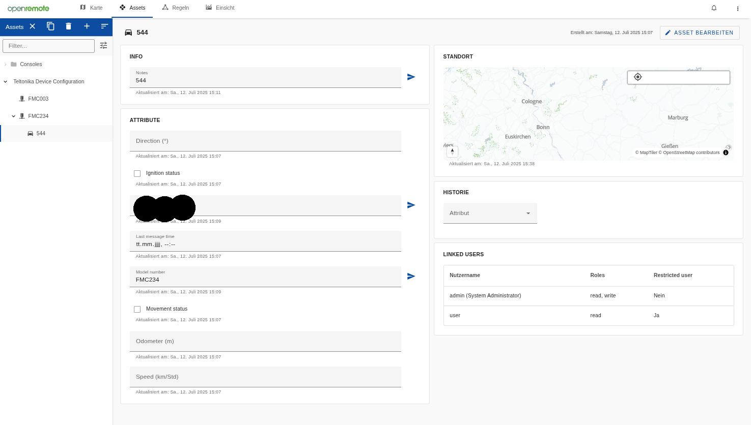

I have added a car asset, chose the FMC234 as parent and entered the model and imei number.
Is this the moment when it should appear on the map?

Hello Panos,
disabling the EYE sensor scan helped. It appeared in openremote, finally :partying_face:
There are many possible AVL’s that might appear when the eye function is turned on.
Since they are binary coded and I don’t need the sensor right now, I won’t add them to the parameter data.
If you have any future plans to add eye sensor support and need some data for testing, let me know.
Now I will try to get familiar with openremote.
Thank you for your help and your patience!
