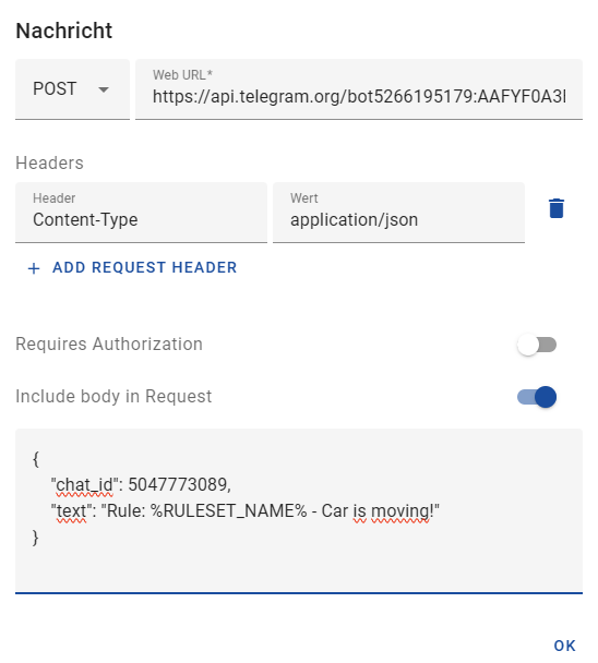

I came across this old post because I was also testing telegram notifications. Messages can be sent using the following settings.
Add Then… Action Webhook
Enter the following in Web URL: https://api.telegram.org/bot<YOUR_BOT_TOKEN>/sendMessage
Add Request header: Content-Type with value application/json
Activate Include Body Request and insert the chat_id with the text to be sent. However, it seems that not many variables are possible here.
Hope this helps!
