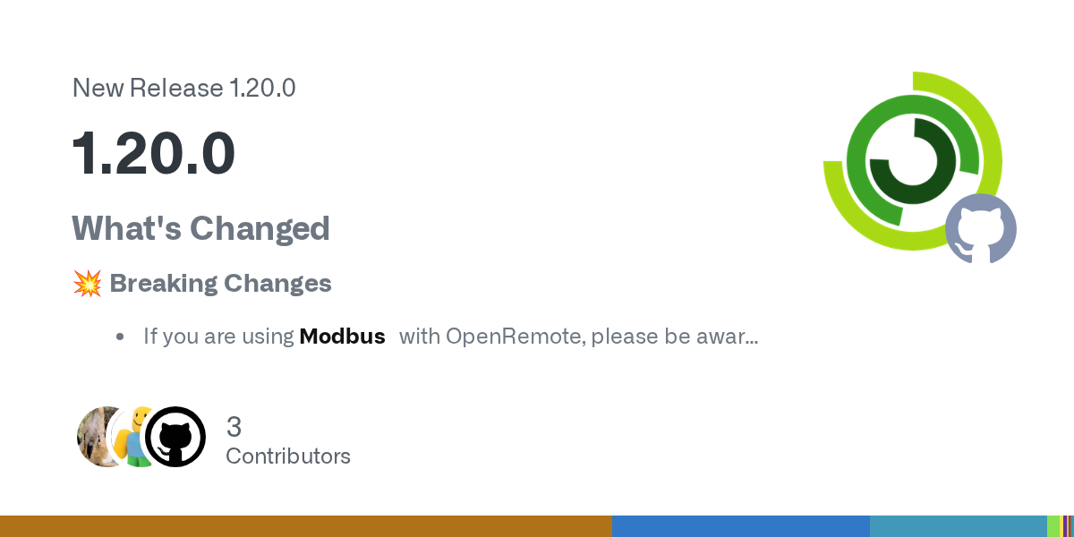

Hi @mito, today we released OpenRemote 1.20.0 which includes all those fix/modbusRTU branch changes.
For release notes, see:
