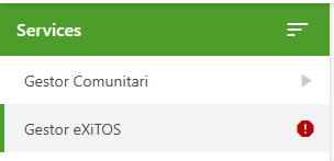

I have recently implemented my Home Assistant addon (named eXiTOS) to my Open Remote project. However, every time I try to use it I see this red symbol next to it.
What leaves me with doubts is the idea of my external service completely works fine, and I can do anything I can do within Home Assistant directly. On the other hand, I have also been trying to send some data recollected from Home Assistant (which this addon works with) to Open Remote, and I this is where the problem lays. Is there a way to see the warning or whatever may be causing this?

I’d assume something would be visible in the Manager Docker container logs?
The icon normally means the “external service is unavailable”.
As mentioned in the documentation on external services:
If OpenRemote does not receive a heartbeat within the 60-second TTL, the service is marked as unavailable in the Manager UI.
