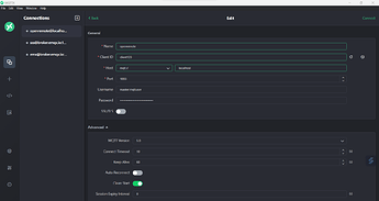

I was able to connect MQTTX with localhost and GET and POST data using MQTTX software:
