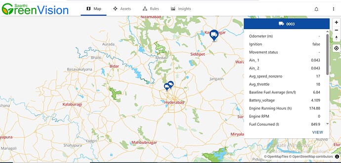

Why am I not able to see different coloured map markers?
Hi my manager_config.json looks like this :

TruckAsset is my custom asset that i have created but the name is exactly “TruckAsset” in the file that I have created.
I have used the fleet-management repo
But my map markers remain blue

Hi, it still isn’t working for me:

what I am thinking the issue is that can_rpm is an attribute I added via the GUI, meaning that in the truck asset, can_rpm doesn’t exist by default. Is that why the colour remains the same?
I have also added the map styling via a JSON generated by chatgpt which gaves rivers and landfills the colours. So is the issue?

Hey @Saarthi, the marker “range” config will only apply when the attribute is present, has the correct type “number/integer/…” and the value matches any of the configured values.
So by default if the attribute doesn’t contain a value within any of the specified ranges it should show the label you specified with the default asset color.
Once you specify a value within any of the ranges you should see the color change.
