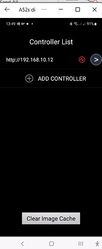

I’ve installed OpenRemote on my PC, however the android app is not able to connect to the Web server, not clear why.
I’ve installed the OpenRemote on my Windows 10 PC, with default firewall setting,
Android 12 is installed on my phone.
Setting on the phone are:
URL: 192.168.10.12 (IP address of the Openremote server)
Default Panel Name: (empty)
Username: admin
Password: secret
X Scale = Y Ccale =1
The phone is not able to connect to the server
