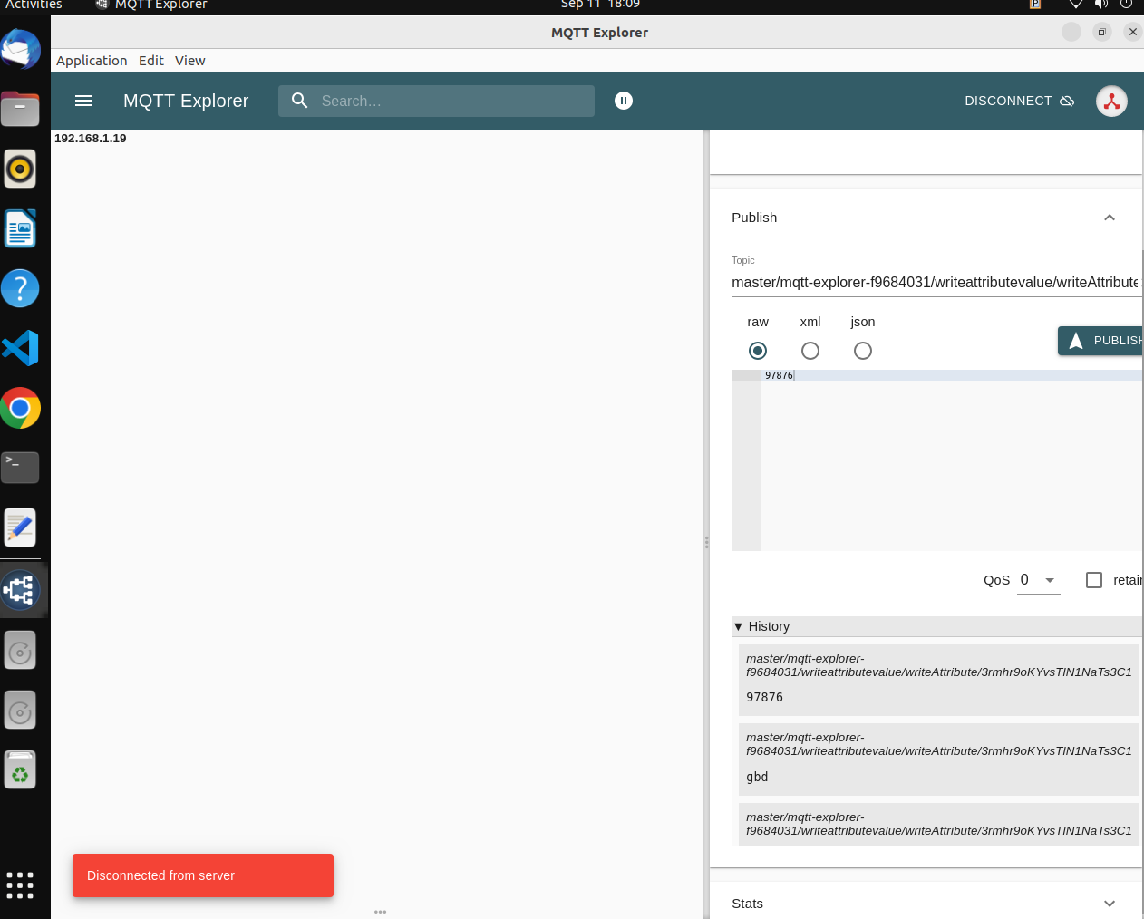

The problem with port 1883 has been resolved but I cannot publish anything when I want to publish I get an error “disconnected from server”

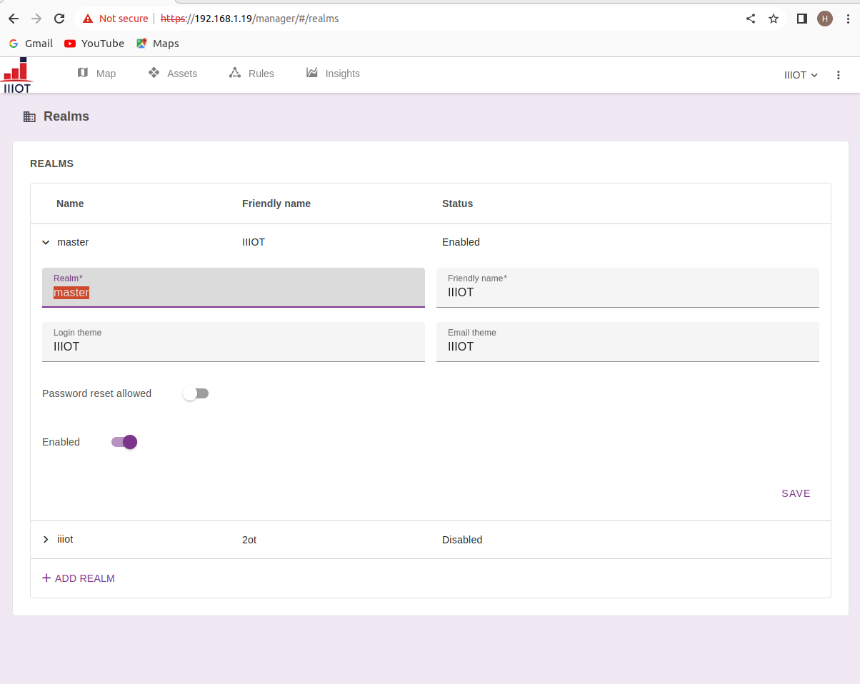

The realm name is master itself. IIIOT is the friendly name given to it
And even if I change it to IIIOT It doesn’t work
You seem to be jumping between publishing and subscribing; the topic format for both is defined in the wiki, some key points:
- Make sure the realm is correct
- Make sure the asset ID and attribute name is correct (case sensitive)
- Make sure the client ID in the topic matches your MQTT client client ID (some clients have an option enabled by default to append timestamp to the client ID so you need to disable that)
Look at the logs of the or-manager-1 container for information about failures.

Post pictures for user option in master. And also post yml file here
So, after successfully connected (mqttexplorer with openremote)
and i have observed that you created a attribute , name “writeAttribute” is Number type attribute and when you send data from mqttexplorer send data
So, you are getting disconnected error .
to fixed this issue First,

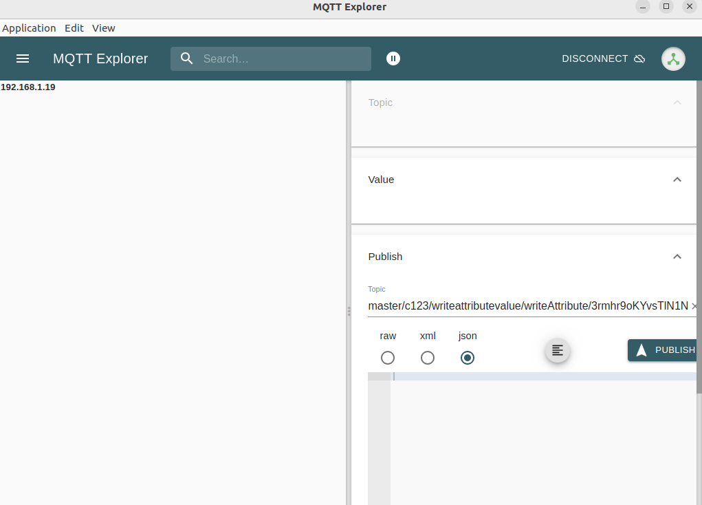

set topic for publish data — master/client987/writeattributevalue/writeAttribute/deviceid
this client987 – cliend id should be match , pls match the same
then click on “Advance” tab and check the id
and here i able to send data in sub attribute below

I have sent data in all three formats but its showing the same error
