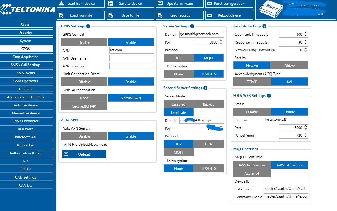

I have opened the port 8883:8883 in my ports section of the proxy in my docker compose file.

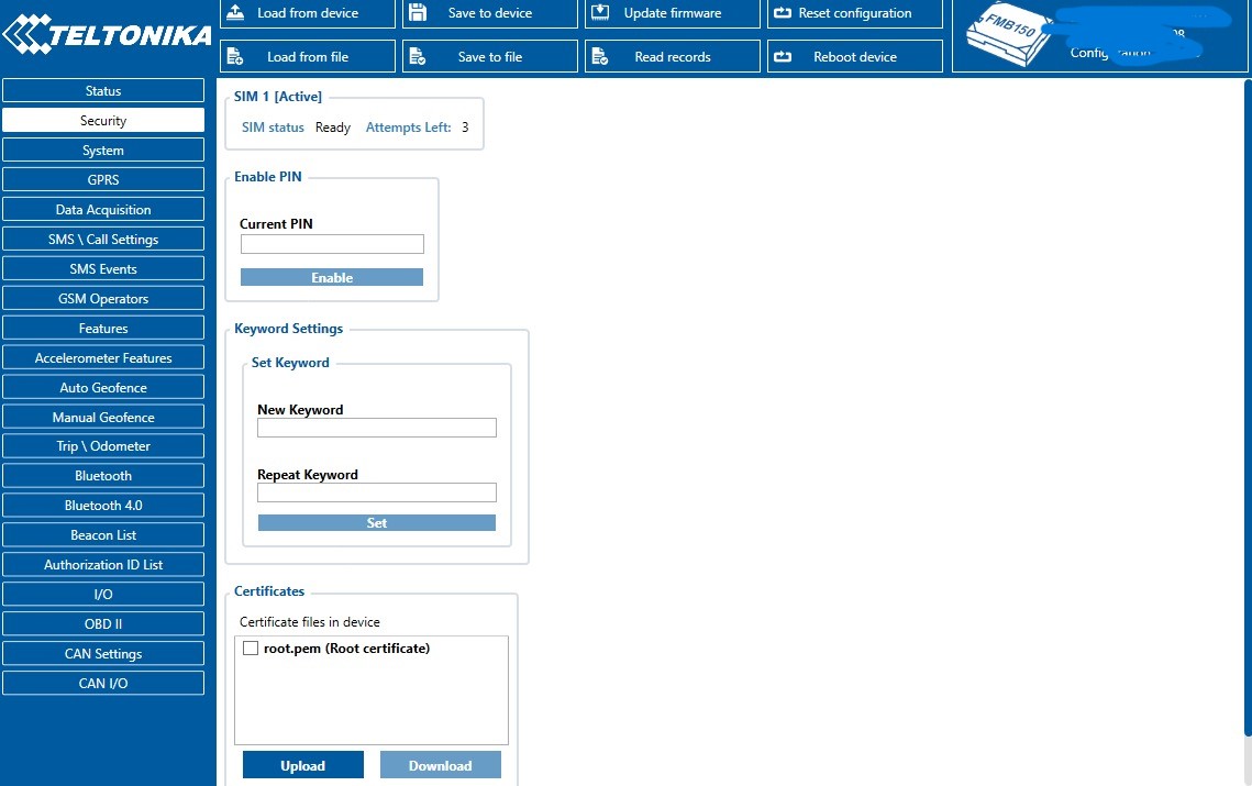

I have also uploaded the fullchain-reverse.pem file in my teltonika configurator of my FMB150 device.
I created teltonika asset but I cant see the data anywhere.

Hello @Saarthi ,
Yet again, your logs, and screenshots, do not show anything that could point to any issue.
Please double-check the quickstart and tutorial and make sure that everything has been configured correctly. I believe that you haven’t correctly configured the device you’re trying to use.

Hey @Saarthi ,
Have you correctly set the codec that is being sent to Codec JSON? Also, I’d recommend double-checking the proxy logs to see if there are any issues with the device when it is trying to connect.

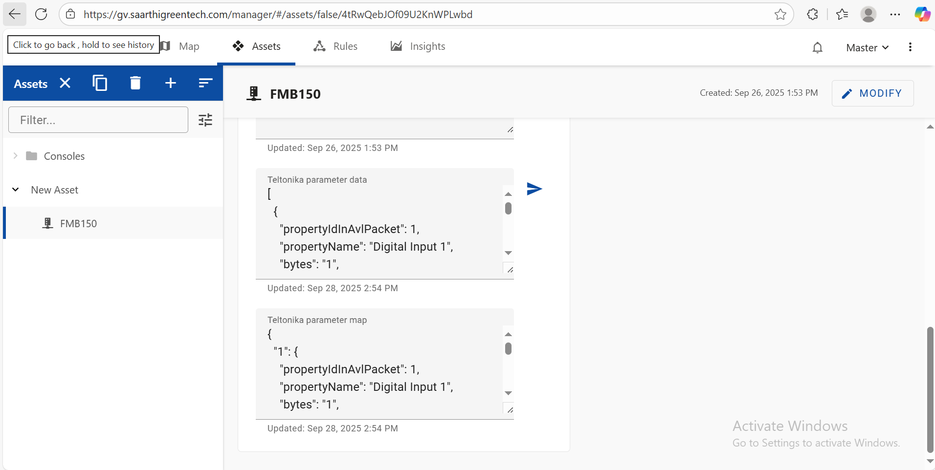

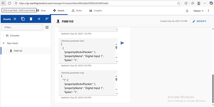

Can you share some example screenshots of how the incoming teltonika data looks like? like the json and where the attributes would be visible?

This seems like a configuration issue on the device side, the Un-supported request sub error shows that something is configured incorrectly in the MQTT settings on the MQTT settings.
In fact, I can see that you do have configured the MQTT settings incorrectly on the screenshots above. Please recheck the tutorial and enter the correct values there.

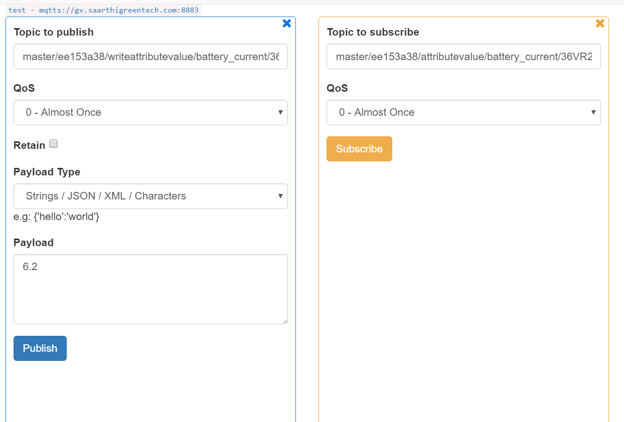

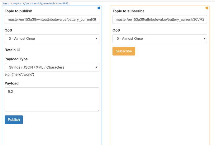

Okay, let’s say I dont use teltonika device to send data and I use a simple PLC device which sends the data in JSON. How can I process that in openremote?
MQTTBox is the only time I have seen the data coming.
I am following the above tutorial but after point of Run as MQTT Publisher , I am completely lost.

Hey @Saarthi ,
You linked a guide written for Teltonika Networks devices, which is out of scope for the fleet management integration. This means that you can use the generic OpenRemote documentation to configure how your devices connect to OpenRemote’s MQTT broker.
If you are sending data from Flespi to OpenRemote, you can use Agents to connect OpenRemote to external services to retrieve data, or you can use the MQTT service user you created to send data to OpenRemote’s MQTT broker. I’m not familiar with Flespi’s APIs or functionality so I can’t help you much further.
Here’s the documentation for publishing attribute updates to our MQTT broker: Manager APIs | OpenRemote Documentation
And a thread that can help with formatting the messages published to the MQTT broker: Question about JSON format for MQTT ipaddress / geojson
