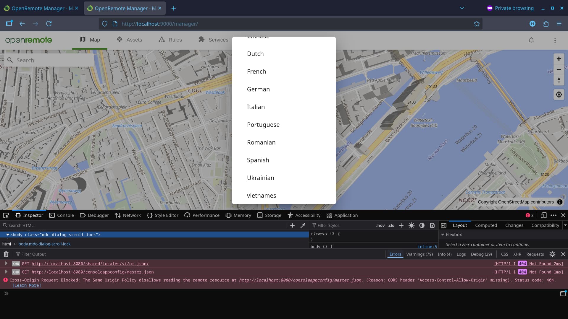

I tried adding a new language but failed
First, I declared the new language in ui/component/core/src/index.ts
export const DEFAULT_LANGUAGES: Languages = {
    vi: "vietnamese"
and added the translation file to ui/app/shared/locales/vi/or.js. The language appeared in the menu, but when I selected it, the console showed errors
GET http://localhost:8080/shared/locales/vi/or.json/ [HTTP/1.1 404 Not Found]
GET http://localhost:8080/consoleappconfig/master.json [HTTP/1.1 404 Not Found]
Cross-Origin Request Blocked: The Same Origin Policy disallows reading the remote resource at http://localhost:8080/consoleappconfig/master.json ...
Then, I changed the translation file directory according to the guide How do I try an unsupported language?](How do I try an unsupported language?), but it still didn’t work. I even tried modifying existing translation files, but nothing translated. Could you please point out where I went wrong? Thank you.

I’ve tried everything you mentioned; I ran ./gradlew clean installDist in the root (openremote) directory and npm run serve in the ui/app/manager directory, but nothing happened. I even discovered that when I tried modifying an existing language file, after building, the language file built in the ui/app/shared/build/…/locales directory didn’t reflect any content changes.

  • Your browser logs show a request to ... /shared/locales/vi/or.json/,
    which is with a trailing slash. Does it respond correctly without the trailing slash?

Thank you, Martin. I didn’t build (forgot to add the --build args) when running docker-compose -f profile/dev-ui.yml up . It’s working perfectly now.
