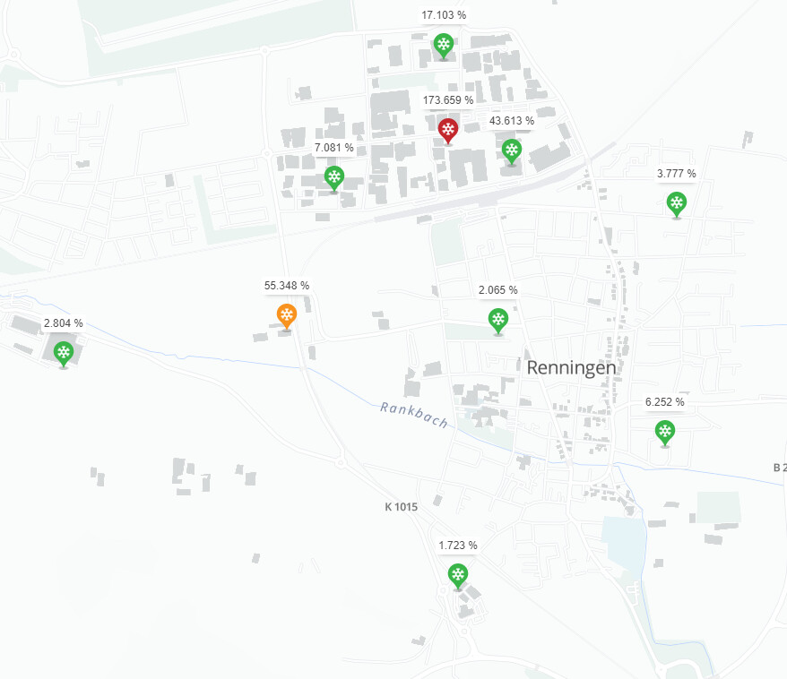

you can add a label, which appears on top of the marker, so you can see directly on the map, which asset has which problem.
"markers": {
"ElectricityProducerSolarAsset": {
"attributeName": "energyExportTotal",
"showLabel": true,
"showUnits": true,
"colours": {
"type": "range",
"ranges": [
"max": 50,
"colour": "39B54A"
"max": 80,
"colour": "F7931E"
"max": 100,
"colour": "C1272D"
Unfortunately I have no other idea, except to write something in the groovy rules.
