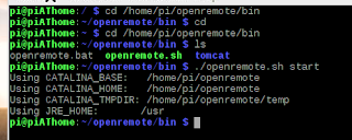

Instead,
I am using the preinstalled version of Node-RED (see the attached example) where rules are generated and interpreted. The latter could be the occasion of another discussion…
To summarize, the installation of OR 2.5 from “out of the box” Raspian Jessie take just a few lines and a couple of minutes only… Again, not sure this is the best option for any use!
